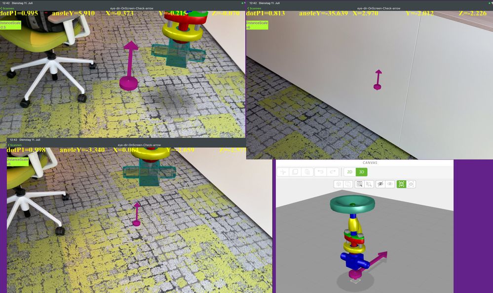

I would like to ask the community if there is a way to orient a 3D arrow following the direction of the camera.
I mean, I have already obtained the eyepos, eyedir & eyeup values. I know how to use eyepos, but I don't know how to use eyedir & eyeup values in order to give an arrow the right direction.
Currently, what I have built is a test project with 2 views:
1) a view used from a mobile device that every second send to Thingworx eyepos values.
2) a view used in preview mode on a laptop that gets the eyepos values from Thingworx and gives these values to a 3D moving gauge, simulating the position of the mobile device in the area.
But this 3D gauge is in billboard mode, so it's always showing his main face.
I would like to transform this billboard gauge into a rotating arrow pointing the direction of the camera.
Any ideas?

Hi @aletenti2 ,
I think this is only a problem of calculation when you have aready  the position of the device and the eye vector from the tracking event.
So when you have an arrow which is directly aligned with the view then possible you do not have from this a more value , because you will see only the tail of it - so some circle on the screen. Therefore possibly it will be better to have the arrow alligned with the xz plane - so this  means to rotate around the Y axis in view direction and possibly to adapt the height of the arrow part  in Y direction.
My approach here is simple. I will set the position in view direction (adding the eye position to the eye direction vector with scale) and will rotate around Y something like this:

Then tested and have this behavior on IOS - IPad device:
