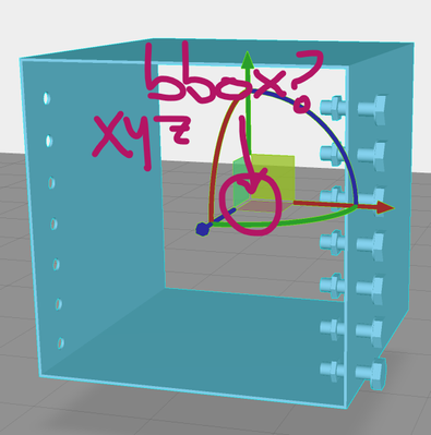

That lead me to investigate rotating the model (or model item) myself with Java Script. What I found out is that, while you can rotate a model (or model item) programmatically, you can't just change the rx/ry/rz variables because those values are the GLOBAL WORLD AXES values. What I want to do is rotate the part in place, similar to what you can do at design-time by manipulating the XYZABC triad (see picture).
This, led me to a conversation with PTC regarding the use of the CAD Shell Tool command utility and the creation of a PVS file which shows, allegedly, all information regarding location and orientation of parts.
So, finally, my question: Does anyone know what is the format if the PVS file? Does anyone have any specification? I can see my individual boolean solids in there, and I do have a 'bbox' value, which I am assuming provides some initial positional reference, but it gets confusing when you look at some of the instantiated children components.

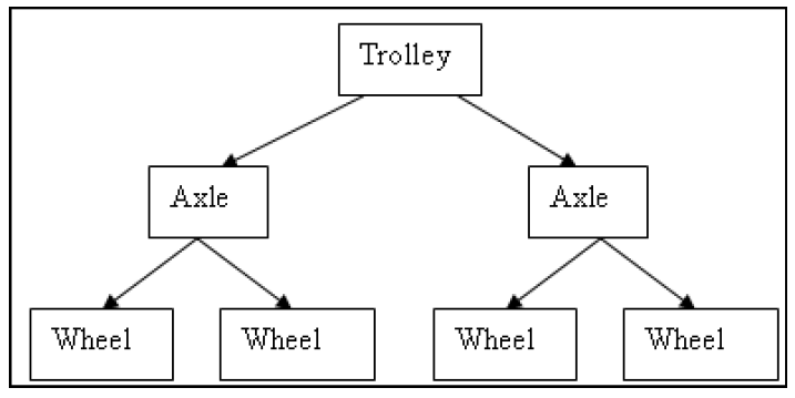

world. For example, consider a structure made up of 3 parts:
• Trolley
• Axle
• Wheel
These can be pulled into an assembly referred to as a Tree, and which represents
the real trolley with 2 axles and 4 wheels.

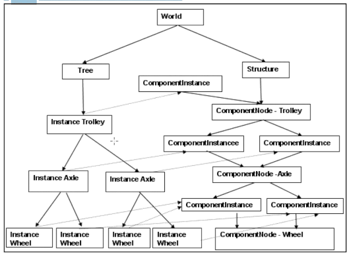

A ComponentInstance creates an instance of a ComponentNode or
ComponentProxy when it is instantiated in the Tree. Therefore, the assembly
above can be represented as follows:

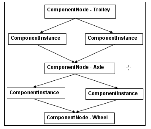

Each ComponentNode contains the same information for all instances of that
component, that is, the properties and files names of secondary content such as 3D
shapes, drawings, images, and so on. This hierarchy is grouped under a structure.
A structure can be associated with a .pvs file and represents the contents of that
file.
To realize the fully expanded instance structure, the structure is expanded to create
a Tree that contains instances as follows:
Methods are provided on the instance to access information. However, these
methods retrieve the relevant information from the ComponentInstance or
ComponentNode. The information is therefore, stored only where necessary.

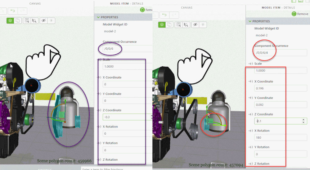

1.1.)we can read the coordinates for each component in euler angle notation x,y,z, rx,ry,rz,  (xyz translation and rx,ry,rz rotations) For this we can use creo view toolkit (java , web or Web.gl toolkit - tools provided by PTC) This requires some programming work. IT is possible that already implementation of such tools based on Creo View toolkit exist already and are offered by some ptc dev partners
1.2) we can also extract the components via the ui. When we check an assembly in Creo View (express)
We can do the same in Vuforia Studio when we define for each compoent a modelItem widget and specify the correct Component Occurrence /in studio  Component /Part Id path - in Creo View
So we can see that when we define a modelItem for each component /path we can extract manually  with some additional work the coordinates for specific component branch.
ROOT CSYS - SubAssembly CSYS  .... Part CSYS (part default coordinate system)
This means all points in an geometry files are in respect to the part coordinate system. This could be different depending how the part was created. For example you can have a cube where the coord system origin is in the top left front corner or on the bottom , right corner or in the middle of the cube etc.… For the PVZ file this definition is implemented in the *.ol / geometries files
Then in the assembly pvs file we have assemblies and subassemblies definitions. For example in a assembly we ca  define for each component  the x,y,z, rx,ry,rz of the part csys. When we have a sub assembly then we have to use the sub assembly coordinate system. This means that the coordinate what we achieve for a component is always in respect to the parent assembly. When we have more levels of components, we have to calculated the coordinates along the assembly component paths.
