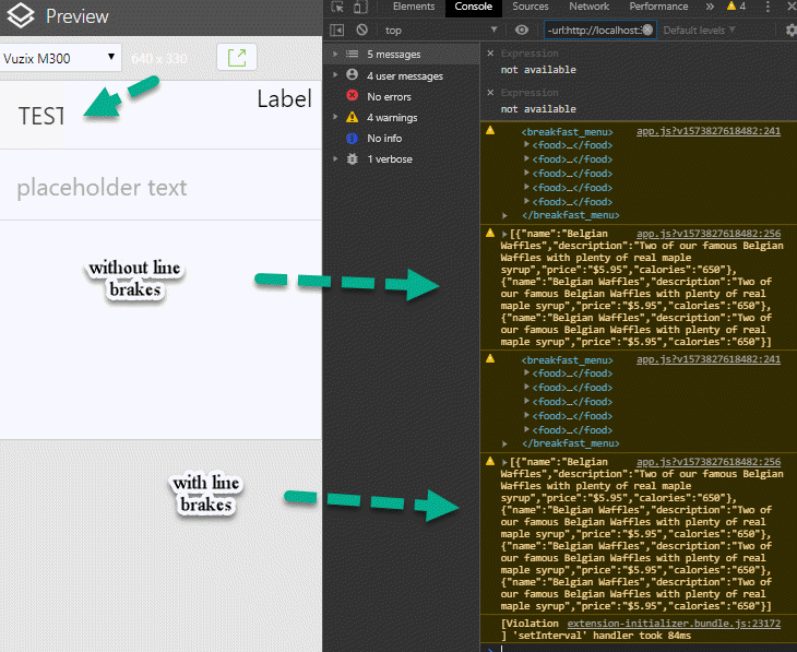

And then used some code like this:
var parser = new DOMParser();
var stringContainingXMLSource = '<?xml version="1.0" encoding="UTF-8"?><note><to>Tove</to> <from>Jani</from><heading>Reminder</heading><body>Dont forget me this weekend!</body></note>'
var doc = parser.parseFromString(stringContainingXMLSource, "application/xml");
console.warn(doc)
function loadXMLDoc(fileName) {
 var xmlhttp = new XMLHttpRequest();
 xmlhttp.onreadystatechange = function() {
 if (this.readyState == 4 && this.status == 200) {
 myFunction(this);
 xmlhttp.open("GET", "app/resources/Uploaded/"+fileName+".xml" , true);
 xmlhttp.send();
var myJsonArray=[]
function myFunction(xml) {
 var x, i, xmlDoc, table;
 var my_obj= {}
 xmlDoc = xml.responseXML;
 x = xmlDoc.getElementsByTagName("breakfast_menu")
 for (i = 0; i < x.length; i++) {
 console.warn(x[i])
 my_obj['name'] = x[i].getElementsByTagName("name")[0].childNodes[0].nodeValue
 my_obj['description'] = x[i].getElementsByTagName("description")[0].childNodes[0].nodeValue
 my_obj['price'] = x[i].getElementsByTagName("price")[0].childNodes[0].nodeValue
 my_obj['calories'] = x[i].getElementsByTagName("calories")[0].childNodes[0].nodeValue
 myJsonArray.push(my_obj)
 //document.getElementById("demo").innerHTML = table;
 console.warn(JSON.stringify(myJsonArray))
$scope.testFunc=function() { loadXMLDoc('example1')
 loadXMLDoc('exampleLineBrake')
where the example1.xml has the same content as exampoleLineBrake.xml but it does not have any line brakes
But I did not face any problems there. So my question is ,  what is actually the issue here?

thanks @RolandRaytchev for sharing your code, this helped a lot. One thing I discovered is, that it worked better for me if I used
x= xmlDoc.getElementsByTagName("food") instead of:
So now the loop for (i = 0; i < x.length; i++) ... will work with a length of 4 instead of just 1.
