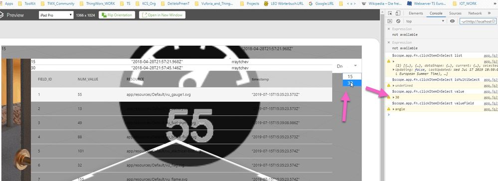

2.) So here we can print first the $scope and from there we can search for some other functionality  here $scope.app.fn
Now to check if this work we can define the following functions:
$scope.app.fn.clickItemInRepeater = function(item,list,isMultiSelect)
//other name for twx.app
   console.log("twx.app.fn.clickItemInRepeater item"); console.warn(item);
  console.log("twx.app.fn.clickItemInRepeater list"); console.warn(list);
  console.log("twx.app.fn.clickItemInRepeater isMultiSelect"); console.warn(isMultiSelect);
$scope.app.fn.clickItemInSelect= function(list,isMultiSelect,value,valueField)
   console.log("$scope.app.fn.clickItemInSelect list"); console.warn(list);
  console.log("$scope.app.fn.clickItemInSelect isMultiSelect"); console.warn(isMultiSelect);
  console.log("$scope.app.fn.clickItemInSelect value"); console.warn(value);
  console.log("$scope.app.fn.clickItemInSelect valueField"); console.warn(valueField);
3.) And test in the console windows of chrome
3.1)  clickItemInRepeater funciton for dataGrid and repeater widgets
3.2) and for the slect widget:
