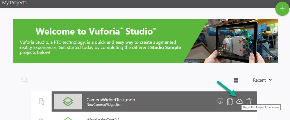

Hi @Naveen_K,
you can also use the Studio UI and unpublish the proejct.
Later you can publish the proejct. What is the effect then?
