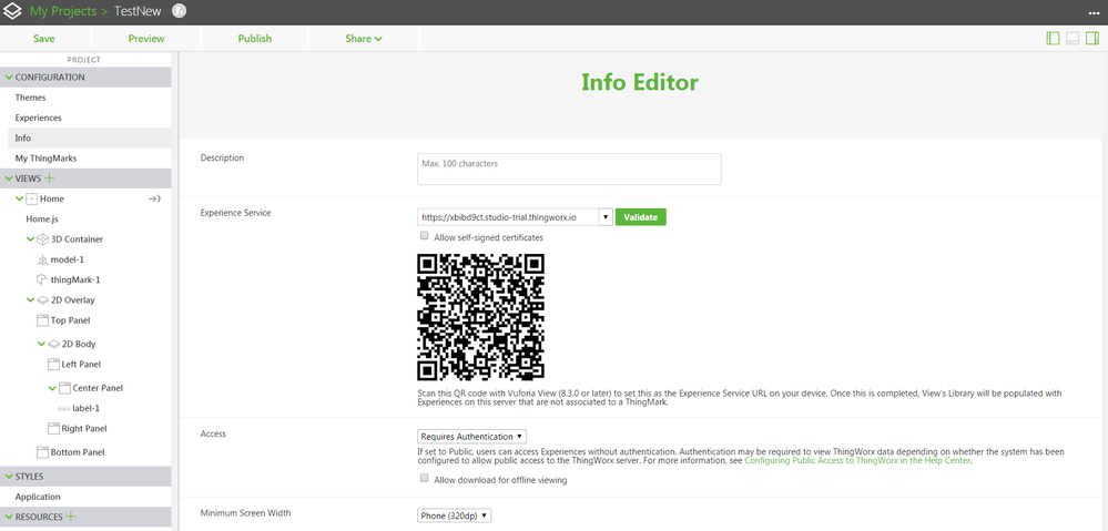

Open Studio instance and try with a new test project<info<Experience service . You can see below screenshot. Just check if this is working. Meanwhile i am checking with dev-ops team if everything is ok with this instance.

when i click on authenticate, i am getting the below error.
@Rakesh_Singh
Could you please ping this url and see what it returns: https://83b87546f7ceabfd.studio-trial.vuforia.io/ExperienceService/ping
Also please try to validate Experience service url with some other network, May be some firewall is blocking this. I confirmed with dev-ops team this Experience service url is up and working.
