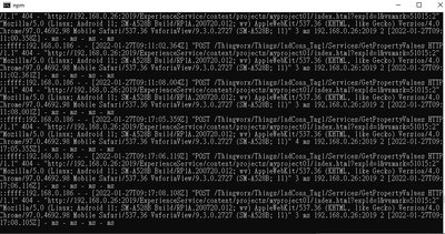

I had my Thingworx and Vuforia Experience/Studio installed on the same pc within Virtualbox.
In Vuforia Studio preview, the data get from Thingworx is correct, but
in Vuforia View, it's incorrect (Can't auto refresh).
Here are some interesting phenomenon, and must be the cause.
While Studio View is connected, the Experiece service log shows
which 192.168.0.26 is my pc's correct address, and 192.168.0.186 is not correct. (don't know why use this ip address!?)
And in Vuforia Sudio preview, the ip address are all correct/the same, so data is correctly auto refreshed.
Please advise, thank you.

What's your devices ipadress? I would guess 192.168.0.186.
The 404 issue can be permissions on your Thingworx thing for the user you are logged in as on your device or es-public-access user if it's a public experience.

Your suggestion gave me the right direction, and the issue was solved.
