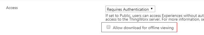

I see that offline capability has been added to version 8.2.1. But I do not understand how to use it.
This is a feature that we are very happy to see be implemented!
You can now select the 'Allow download for offline viewing' option for an experience in the Info tab. This enables users to download the experience to their device and view later.

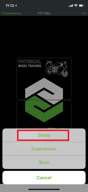

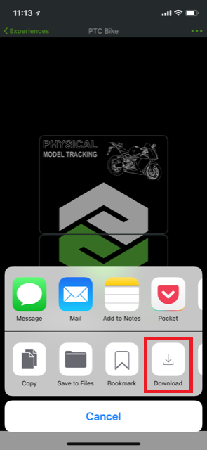

To download from ThingWorx View select, share then download
Click the share option
Click download
Heres steps on how to download from ThingWorx View
