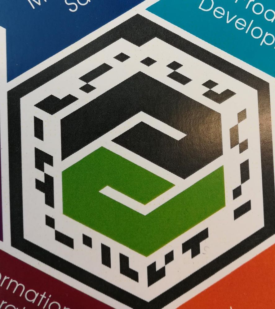

hello everyone, I'm trying to launch an experience with name "citropack" is a thingmark that we gave as a demo by PTC, before the 3D model was placed on the thingmark but now places it in another position, you know what happened? It is worth mentioning that it is a ptc thingmark

This ThingMark seems to be for the View Gallery. There is not an experience "citropack" in the gallery. What do you see when scanning the ThingMark you shared?
I can't seem to read this ThingMark from the screenshot, but based on what @tmccombie said, it's the gallery ThingMark.
So if you scan the gallery ThingMark with a mobile device, it will take you into the Gallery where you can see the PTC examples.  If you scan the gallery ThingMark with a HoloLens, then it will launch an single experience based on the Bosch CytroPac.
So if you're trying to get the CytroPac experience on a mobile device, you'll need something else.
You could try the HBR AR app as it has the CytroPack as an example, although this example was created using Vuforia Engine rather than Vuforia Studio.  You can get the HBR AR app for iOS, Android and HoloLens.
If you are trying to view this on a Hololens, the physical size of the thingmark is important. It will only appear positioned correctly if the thingmark is printed (or displayed, if you are viewing on a screen) at the expected size.

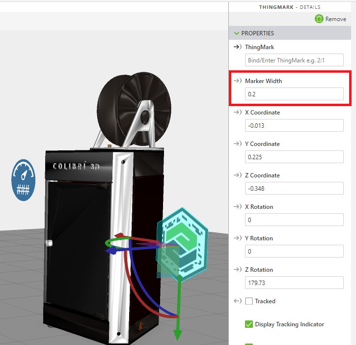

I think you've also posted in another thread and I just gave an answer to that here, but here's the details.
In your experience, you have a ThingMark widget and you have set the Marker Width property to 0.2 which means 20cm.:
So now you need to get the image file for your ThingMark that you are using for this experience and print it out at 20cm wide.  PTC has some instructions in the help about resizing the ThingMark (here) but nowadays, I just import the SVG file into MS Word and change the image width to 20cm.  You'll need to change the image anchor to make sure that it all prints and the margins of your printer don't chop it off.
The important thing is that if you are using the HoloLens, the width of the ThingMark that you scan to place the AR, needs to be exactly the same size as you have specified in the experience.

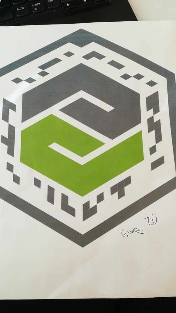

While typing this, I've just seen your video and although you don't show the process of scanning the ThingMark to place the AR, I can see that you are scanning the ThingMark from a screen, so unless it's 20cm wide on screen (measure it with a ruler) then it won't be positioned correctly.
As I said in my other reply, if you just want to show a 3D model in the real world, then it's a lot easier to use a Spatial Target.

thank you very much for the help but I do not know what happens with my experience, the measurements of my thingmark are correct, my project is fine, I publish and when deploying the model it appears in a completely different area. My thingmark measures 20 centimeters, which is what is happening. i attached a video so you have a better idea .

I've seen in the video, that you have bound no number to the thingmark. You should always bind the number of the printed thingmark to the virtual thingmark in your studio. Also I would recommend not moving your device too fast at the beginning; otherwise the tracking might be faulty.
Nice catch! I didn't notice the lack of a thingmark code. That would definitely mess things up. Also, remember to keep the focus on the thingmark after you scan it while the green line traces the thingmark border, that's how it establishes tracking on the thingmark.

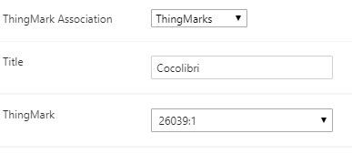

hello thank you very much for the help, I still have the same problem even placing the number of the thingmark in the properties, what will be the problem?
I'm not sure. Does the number you used in the thingmark widget match the number you used on the info panel for the experience, and those numbers match the number for the printed thingmark?
yes is the same number , attatch picture vuforia003.jpegvuforia002.JPGvuforia001.JPG26039-1.png
Are you switching views with different trackers in the Hololens experience the same way you do in the mobile experience? I'm not sure how well that will work on Hololens. If that's the case, have you tried a simpler Hololens experience that only uses a thingmark tracker? (I don't have a Hololens at my location to check for myself.)
yes, I changed the thingmark, I changed the model, I changed the user, I modified the scale, sizes, I printed several thingmark and the problem keeps appearing and not only to me but to several users that I know, I can use the spatial target but that is not the case since I want to test a sequence of maintenance on the machine, a step by step
