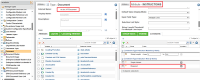

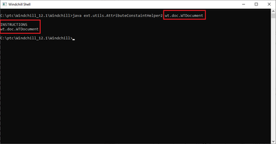

I wrote Java class that gets the info using an SQL statement.
I create an attribute in WTDocument name INSTRUCTIONS and added a Required constraint.
I than tested code in Windchill shell.  It works.
FYI, my advice is to use SQL query rather than Windchill APIs.  The SQL query is MUCH simpler.
I did start by using the Windchill APIs and quickly realized SQL statement was the way to go.

The screen shot shows only one attribute INSTRUCTIONS because that was the only one I created with a Required constraint.
