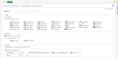

I would like to be able to filter work items by their last modified date - how would I be able to add this as an attribute to an advanced search.

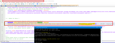

edit advancedSearch.wt.workflow.work.WorkItem property in SearchableAttributesByType.properties.xconf to add thePersistInfo.modifyStamp
run xconfmanager -p and restart :

AL_9355918
3-Newcomer
(To:Fadel)
Thank you so much!
