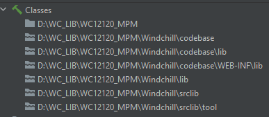

BTW I checked the Windchill version library 12.1.2.0 and I have not found any deprecated method. that you use
TypedUtility.getSearchCondition(mysofttype, true);
so what version library do you use?
PS: My IDE informs me if the method is Deprecated
also check if you have correct library dependencies in your IDE because the class is not in jar files but it is directly in
...\Windchill\codebase\wt\type\TypedUtility.class
 for example my library def looks like this:
PetrH

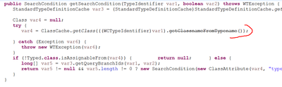

VR_10417596
(To:HelesicPetr)
VR_10417596_0-1684417565645.pngthis is deprecated so I have tried getTypeName() also not working
Class.forName(var1.getClassnameFromTypename());

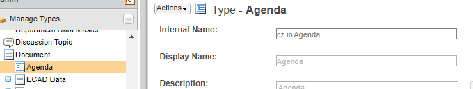

Hi @VR_10417596
Following code works. and query returns just documents of Agenda type.
Windchill 12.1.2.0
QuerySpec querySpec = new QuerySpec();
int idDocObject = querySpec.appendClassList(WTDocument.class, true);
try
	TypeIdentifier tiCheck = ClientTypedUtility.getTypeIdentifier("wt.doc.WTDocument|cz.in.Agenda");
	SearchCondition sc2 = TypedUtility.getSearchCondition(tiCheck, true);
	querySpec.appendWhere(sc2, idDocObject);
	QueryResult find = PersistenceHelper.manager.find((StatementSpec) querySpec);
	while (find.hasMoreElements())
		Persistable[] nextobj = (Persistable[]) find.nextElement();
		WTDocument nextDoc = (WTDocument) nextobj[0];
} catch (WTException e)
	throw new RuntimeException(e);
PS: you used wrong string type definition. You need to use only internal names of type example: "wt.doc.WTDocument|cz.in.Agenda"

VR_10417596
(To:VR_10417596)
Hi
Below API is deprecated so I need alternative API
Vishvanatha

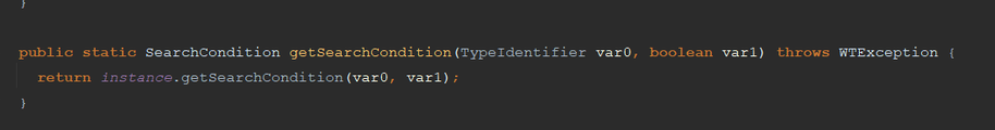

VR_10417596
(To:HelesicPetr)
Hi PetrH,
Thanks for your examples but there is an OOTB Deprecated method getClassnameFromTypeName() in WCTypeIdentifier.java. even I had tried for getName(); its not working.
Vishvanatha
HelesicPetr
(To:VR_10417596)
Hi @VR_10417596
In my case it works perfectly. For all my applications.
PetrH
