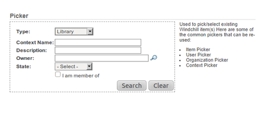

Dears.
Now I have a custom attribute, he contains about 2000 values, I use the Global Enumeration defined constraints, so that the user can only be in the foreground page to select one of these 2000 values, but if user go through the drop-down box to select the desired value is a waste of time, does drop-down box can be added to the filter,  or there are other good ways to achieve it, thank you very much!

Hi @CZ_9645217
It seams that suggestion can help what you need with validator that the text area contains only the string available in the enumeration
Check Picker Component Catalog in the Windchill
wchadress.com/Windchill/app/#ptc1/componentCatalog/componentCatalog?oid=OR%3Awt.org.WTUser%3A207&u8=1

Hi @HelesicPetr
Thanks for your quick reply, I'm sorry I didn't quite understand what you meant, do you mean using the custom Picker functionality for that?
For example, I have one custom attribute named demoIBA, If this property has 2000 values, and now user can only select them via a dropdown box, do you mean to add a customized Picker filter? thank you

Yes I mean to use customization and use custom picker.

thanks @HelesicPetr , do you have any document or link guide how use custom picker to get attribute value?

Hi @CZ_9645217
In Windchill installation there is catalog and one of them is for Pickers.
Check the address in your system
windchillAddress.com/Windchill/app/#ptc1/componentCatalog/componentCatalog?oid=OR%3Awt.org.WTUser%3A207&u8=1
