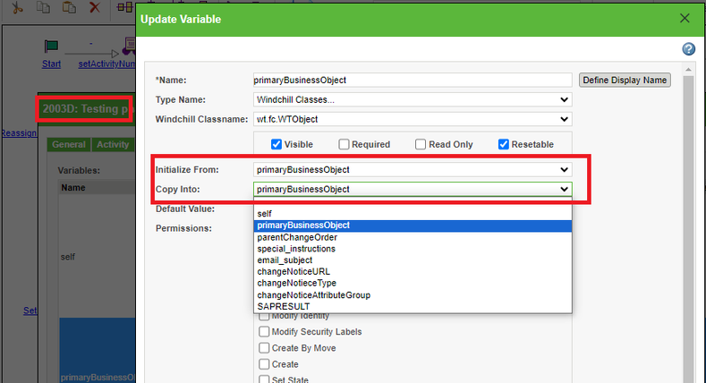

Question: I have defined a boolean variable "Should automatic promotion request be initiated?" within the activity at the approval stage for the automatic promotion request code. I want the code below to execute if this variable is true; otherwise, it should not execute. How can I achieve this?
Question: I want the person in the submitter role who initiated the change review process to be assigned as the "created by" for the promotion request. These questions might be simple, but I haven't been able to find a solution.

Hi Emrec@n
1. You can use the variable in the condition and based on that value go to a right way in the workflow path
usually copy the variable from user task to global variable in the workflow. it is ootb function.
2. I guess that the method assignIterationCreator can not be used to the object that is not versioned. Promotion Request does not have revisions and iterations..
PetrH
Thank you very much for your guidance. How can I copy the selected value within the Activity to a global variable? Do you have a ready method for this? Finally, what method can I use to assign the user to the promotion notice? Do you have any suggestions?🙏🙏🙏
