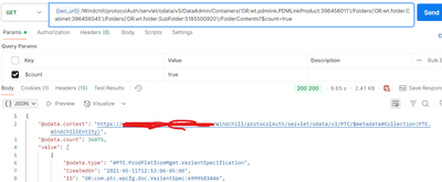

In your request URL I observed the Boolean value missing for $count, there is no issue with the version
https://<url>/Windchill/servlet/odata/v5/DataAdmin/Containers('OR:wt.pdmlink.PDMLinkProduct:681234555')/Folders('OR:wt.folder.Cabinet:681234597')/Folders('OR:wt.folder.SubFolder:681267970')/Folders('OR:wt.folder.SubFolder:681267975')/FolderContents?$count=true

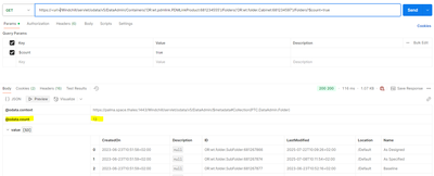

I've modified the request as you proposed : "$count=true", but server seems to request first all elements before to count and I get always the same error message 😞"The returned query result has exceeded the query limit, and only 50,000 result returned."
Sorry, I was confusing with the rest request. My apologise.
With ODATA request it works fine, Thanks a lot !
