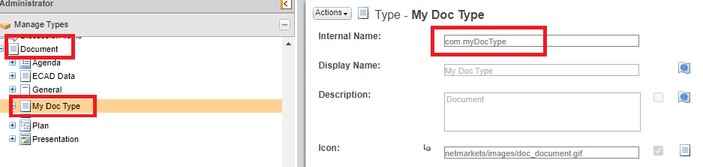

Hi @YannickM
The string "wt.doc.WTDocument|com.myDocType" is full definition of Subtype WTDocument object so the subtype has to exist in type and attribute management.
go there and check what string definition is yours WTDocument subtype and use it.
The string has to contains full definition same as my example. The separator is |
Main type
plus subtype
Hope this can help.

YannickM
(To:HelesicPetr)
Thank yóu very much. I found my mistake. I had a sub-subtype of Document. So in your example a subtype of "My Doc Type". I only included the internal Name of the "Document" and my Subtype. So now I tried it with including the whole path and it works:
 wt.doc.WTDocument|com.myDocType|com.myDocType.mySubDocType

Hi @YannickM
That's right if you use more levels you need to specify full path to subtype.

HelesicPetr
(To:YannickM)
String com.myDoctype is your subtype than has to exists in type and attribute management
Change it to your type
