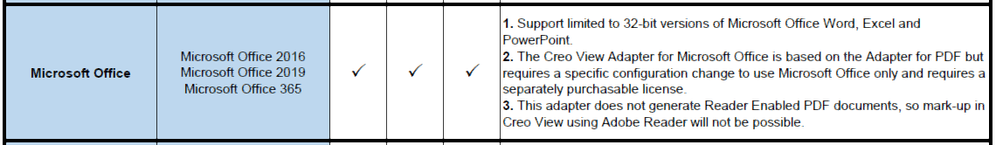

Does the approach in your Word document require any additional licenses from PTC? Last time I checked, Creo View Adapter for PDF was $8,190/yr and Creo View Adaper for MS Office was $2,580/yr. I was under the impression that the solution posted at the top of this thread did not require these licenses, but I may be wrong.
We're not aware of any additional license cost.
This is what I was going by. See note 2. It's from the Creo View 7.0 Adapters Software Matrices:
I'm not opposed to going through the steps to test it out, but I'd rather not waste the time if it really does need a separate dedicated license to even function.
Because we put a lot of documents into Windchill, I checked on this with my VAR a couple of years ago. Unless things have changed, it did require a license and as far as I remember, said license was not cheap.
I got a word from our VAR that in note 2. the mentioned license refers to MS Office license required on the worker machine, not any Adobe thingies which cost a fortune a couple of years ago.
