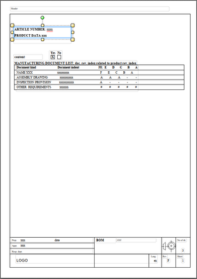

We have a Windchill change process where we need to generate custom partslist (BOM) in a pdf format with a predefined template (header , footer , logo etc).
Inspite of all the efforts(customization) from the team it still is not possible. (I know this is not an OOTB function from Windchill)
I reach out to all of you to seek your comments /suggestions

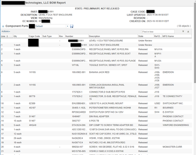

This is the closest we came to your description. Its not PDF but normal Windchill page that the user can print to PDF. It still has some issues I am trying to work out, mainly WYSIWYG stuff where the column widths get funny when printed. It has a header and footer and is triggered from an action added to Reports on the Structure tab of a Part. Lots of unknowns in your description. Single or Multilevel? Are you applying any default config spec or filter?  Personally, I consider anything PDF to be for humans only and throw away. Its a nice to have but not true source once printed.  The major trick with this report was getting the BOM table to display fully, no matter how long it was. Windchill tables have a viewing window and a scrollbar so when printed, you only get what is in that window.

Thank you very much ! Our requirements are similar to what you point to . We generate the BOM with AML/AVL from the reports menu .
We however intend to export the same in a certain format due to mandatory requirements  and this is where the limitations hit us. Interestingly we use similar formats for CAD outputs using templates and that works fine.
