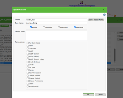

Even though setting is on, this value is not visible at all. Is there anything else we should check?

Please can you share where is your variable defined take a screenshots of the workflow definition and the variable.
There are several settings that you can allow to see the variable or not see in the workflow.

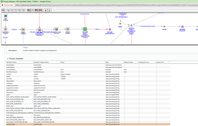

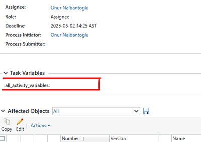

I did not say there was an error in the first message I wrote. The value I defined as a variable in the task is shown like this. No data entry can be made.
I tried the same situation by creating a ".class" and using it as an enumeration.
The task page shows me like this. The logs do not write anything either.

I asked for some screenshot from the configuration not the results.
btw if you go to a workflow process manager does have the variable a value?
Also I would add that the variables are visible and editable in the task assigned to the user. not the Object info page

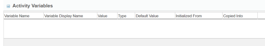

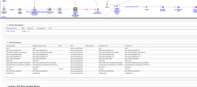

HelesicPetr
(To:Engine)
Hi @Engine
I guess that you think it is task variable but it is process variable. It is different one.
A Task variable is the variable that is on the user's activity task and can be copied from the process variable.
You show the variable that is not task variable.
Click on the APL Hala task and it shows you the task variables

Hi @Engine
The variable is empty. The value is not there.

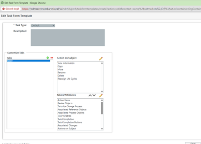

Does a task activity contain the variables?
https://www.ptc.com/en/support/article/CS283680?source=search
