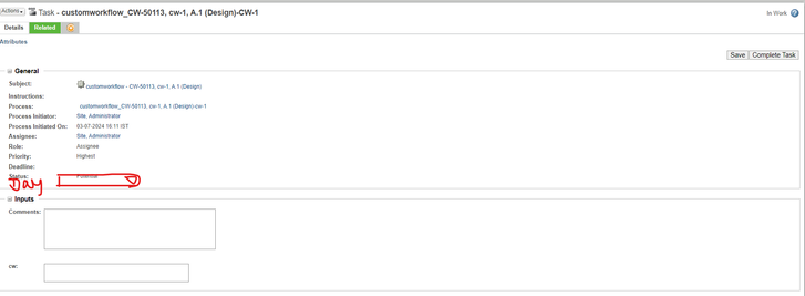

I wanted the dropdown as i mentioned in the given below image. I gone through the suggested article dropdown is not coming.

I run this property after i took restart and i created a new workflow i add my class name with package in otherclass, it is not allowing to complete.

Hi @RaikarRaghu
The reason could be that your class does not exist or is not well defined or you miss some compilation of rbinfo.
Who knows I don't know what you did. .
In the Default value you should see the list of values. If it is not there, then you have done something wrong,
PetrH
