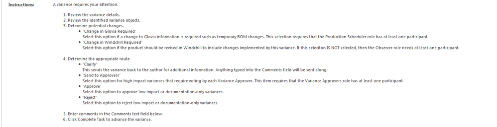

I want to use HTML lists to create a better experience for my users and have succesfully done so.  Here is that code:
A variance requires your attention.
<ol type="1"><li>Review the variance details.
<li>Review the identified variance objects.
<li>Determine potential changes.
		<ul><li>"Change in Glovia Required"
		<dl><dt>Select this option if a change to Glovia information is required such as temporary BOM changes.  This selection requires that the Production Scheduler role has at least one participant.</dl>
		<li>"Change in Windchill Required"
		<dl><dt>Select this option if the product should be revised in Windchill to include changes implemented by this variance.  If this seleciton IS NOT selected, then the Observer role needs at least one participant.</dl></ul>
<li>Determine the appropriate route.
		<ul><li>"Clarify"
		<dl><dt>This sends the variance back to the author for additional information.  Anything typed into the Comments field will be sent along.</dl>
		<li>"Send to Approvers"
		<dl><dt>Select this option for high impact variances that require voting by each Variance Approver.  This item requires that the Variance Approvers role has at least one participant.</dl>
		<li>"Approve"
		<dl><dt>Select this option to approve low impact or documentation-only variances.</dl>
		<li>"Reject"
		<dl><dt>Select this option to reject low impact or documentation-only variances.</dl></ul>
<li>Enter comments in the Comments text field below.
<li>Click Complete Task to advance the variance.</ol>
The quirks that I ran into exist, I assume, because this field (instructions field in the activities tab of the work item) is meant for plain string input with some html formatting such as <b></b> for bold.
Quirks:
  1. A return after a list declaration will result in a blank list item.
    • Start your first list item immediately after starting the list block.
  2. Completing a list item <li> with it's </li> will result in a blank list item following your actual list item.
    • No idea why this happens, but simply do not use </li> </dt> or </dd> tags.
  3. Each list block <ul> <ol> or <dl> must be terminated.
    • Despite the above behavior for list items, the lists themselves must be termated with their </ul> </ol> or </dl> tags.
I hope this information helps others out there as it took a bit of discovery on my end.
