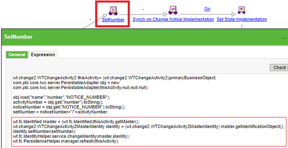

Here is example from WF Activity how to set number activity to a format "CN+/+AtivityNumber"
wt.fc.Identified master = (wt.fc.Identified)thisActivity.getMaster();
wt.change2.WTChangeActivity2MasterIdentity identity = (wt.change2.WTChangeActivity2MasterIdentity) master.getIdentificationObject();
identity.setNumber(setNumber);
wt.fc.IdentityHelper.service.changeIdentity(master,identity);
wt.fc.PersistenceHelper.manager.refresh(thisActivity);

Set the Lifecycle template to advanced and run own workflow in the state where you need.
Place an expresion robot with code in the workflow.
Write code to change the number  in the WF .
PetrH

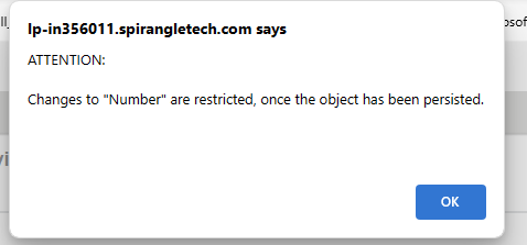

I try to change part number by workflow, but I gives error that cannot change number.
HelesicPetr
(To:MP_10719580)
Hi @MP_10719580
Where do you place the code?
You need to save the object and after the object is stored in database you can change the number.
This is common error, if you put the code as a first node in workflow, and the WF is run before object is stored.
You have to use wait or something that the store operation is done succesfully
PetrH
Thanks for give solution, now it's working.
