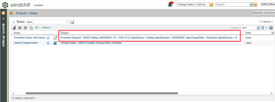

It is doable to change the OOTB task 'Subject' in the UI.  See image below.
As you can see. ONLY tasks from Promotion Request workflows will get the added text.
You never stated EXACTLY how you wanted to change the OOTB display of the task 'Subject' so I just added some static text to show it can be done.

I have this working to your spec.  I think. 😀
I made a workflow that has an expression robot with your code and the String variables you listed.  BTW, I had to add an additional variable that was in your code by not listed.
I edited the data utility that generates the Task 'Subject' to find the workflow variables you listed and get their values.
My code appends the variables' <name> = <value> to the OOTB subject.
Seems to be bombproof. 😀
I can't read Polish so I don't know if the image below is exactly what you need but it does show that the workflow variables' values can be added to the Subject.
