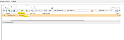

I want to disable New Number coulumn which is present in SaveAs Workspace for particular User.
How I can do that?

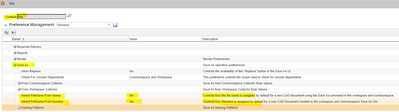

You can try this "Save As" preference at site/org level and change these values. This preference has many options that you try. Please perform it in Dev environment and test all use cases.
I just guess that he needs to restrict the changeing new number from "generated" to another one to a specific user.
This preference does not do that.
