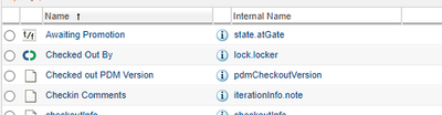

There is a page to see them:
Windchill/app/#ptc1/carambola/tools/createtableview/availableAttributes
Add that your you hostname and URL for your server.
