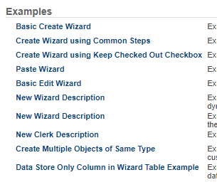

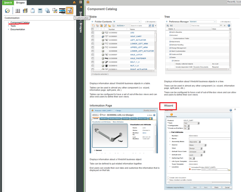

In Windchill installation there is catalog of examples how you can customize wizards....
http://windchillserver.comp.com/Windchill/app/#ptc1/componentCatalog/componentCatalog?oid=OR%3Awt.org.WTUser%3A207&u8=1
hope this can help as a start point
