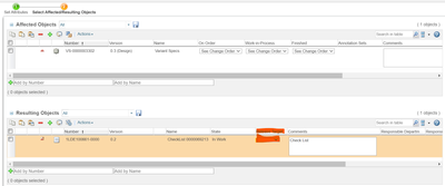

Hi ,
In WC12 for every resulting object the default target state is blank How we can able to remove that or Is there any way to disable it?

Check your lifecycle state for those resulting items. Make sure that "Change" has a state checked for it. You will have to update lifecycles for existing items to pick this up.
@avillanueva  But In WC12 the default target state is blank so How can we remove that
I do not think that this is default so to speak. You need to setup your lifecycles to have that checked to tell it what state you want to move to when objected are completed by a Change Notice. Defaults targets are Change and Obsolescence.  In mine, I do not use Obsolescence so since there is only 1, it always defaults to "Change" which is mapped to Released.

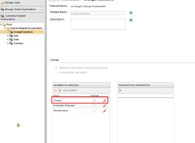

We need to set default in two places to work:
one in Transitions and other is Change Transition RB
