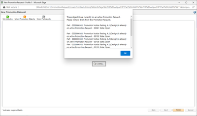

The user would see something like below if using either a listener or a custom form delegate.

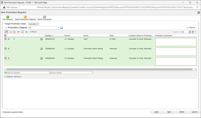

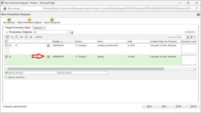

In this example, the seed is the only object that is not on an active Promotion Request.
One of the other objects is on one active Promotion Request, the other is on several (for demo purposes) Promotion Request.

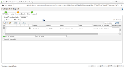

Upon select Finish, the user is return the follow and they cannot continue until they remove the two problem promotable objects.

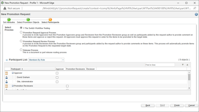

I thought I'd add to this post something I was asked about regarding creating new Promotion Request,
Not only do duplicates need to be automatically stopped but also a specific workflow process MUST be selected if the promotion request contained a specific object type or sub-type.
Below is what I came up with.
Create new Promotion Request that does not have the special sub type.
All workflows are available.
Select Back button and add object of special sub type.
Workflow is automatically selected and CANNOT be edited by the user.
The reason why this workflow is automatically selected is also displayed to the user.
Seems to work well.
