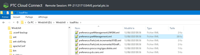

load below file and restart your server :

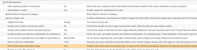

The below highlighted preference is missing.
windchill version using is 12.1.2.4
Fede

Thanks a lot it worked
