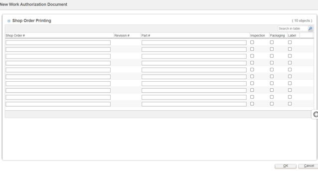

I am looking to create a table with 10 rows. None of the rows have a persistable object. I just take input parameters(One of them is 'Part #' field) and a few checkboxes for the 10 rows and then process it and attach a new document type for each of the 10 part numbers based on all the checkboxes. I am currently able to display the input table currently as below:
Notice how the 'Revision#' is not showing up. It is also using the same StringInputComponent as the 'Shop Order#' and 'Part #' columns but strangely does not have a text box..
Also, the next step is to process each row in the formprocessor, and here is where I am in a bit of confusion. Please feel free to suggest any approaches.
