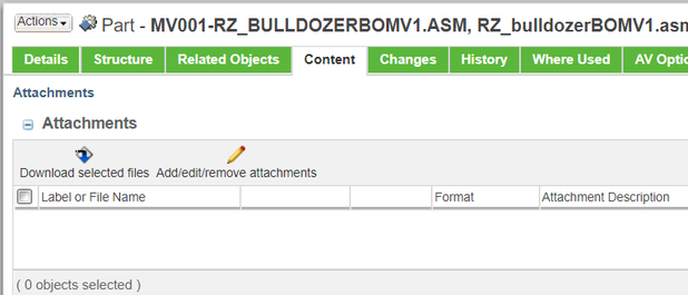

Hello All,
I was wondering if it is possible to attach a PDF document to a WTPart like how we have secondary attachments for WTDocuments. Can you let me know feasibility of the same?

Yes, there is a preference for this at Site level
But fully test this out. It fundamentally changes your data management object model so be sure this is what you want.

Hello @avillanueva ,
Thank you for your response, could you tell me if this functionality can be configured in such a way that the Set Attachments is available for specific type of WTParts?
avillanueva
(To:Sha11)
Honestly do not know. It would require playing in the Type Manager but I think the preference is for all WTParts and subtypes.
@avillanueva is right,
The setting applyes for all WTPart types.

Hi @Sha11
You can activate this functionality in a Preference Management
Attachments on parts set to yes
Then content tab is activated on the detail page.
