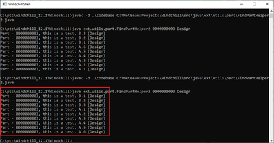

As usual, @HelesicPetr is correct.  There is no getLatestWTPartAtView method. You have to write your own.
I came up with what I think is a fairly simple method that accepts two arguments, WTPart number and View name.
The method gets the desired view using a simple QuerySpec.
If the QuerySpec returns a View (perhaps the view name entered does not exist) the View is used in a second QuerySpec that uses the View and the WTPart number.
The trick is at use order by to set the order of the QueryResult such that the first object in the QueryResult is the object you want.  You simply return that first object.  No need to use a while loop.

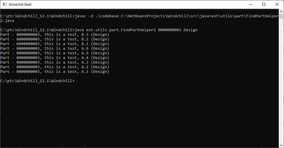

In the images below I show the order the iterations occur in the QueryResult.
Latest rev.iteration to first rev.iteration
Now, suppose I want the latest version first but with first iteration, B.1, B.2, B.3, A.1, you get the idea.
I simply flip the sort order, and I get the new ordering.
If I want A.1 first (first iteration to latest iteration) I flip the sort order again and I get the results I want.
