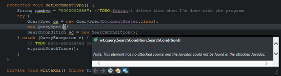

We are using Eclipse to develop Windchill customizations, but we're having some issues displaying the javadoc popup for Windchill's API.

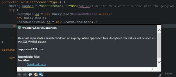

For classes the popup gives me the javadoc information as expected, e.g. SearchCondition:
But when I try to get information about the constructor for SearchCondition the javadoc popup throws an error message: "Note: This element has no attached source and the Javadoc could not be found in the attached Javadoc."

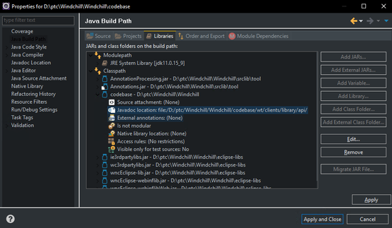

Here you can see that the javadoc location is specified for the codebase:

What version of Windchill are you using? PTC's javadocs were improperly formatted when they first went to java 11 in Windchill 12.0.0.0:
https://www.ptc.com/en/support/article/CS335782
I'm on Windchill 12.0.2.8
The problem I was mentioning was fixed in 12.0.2.6 so this is not your problem. I don't have any other ideas - maybe someone else does.
