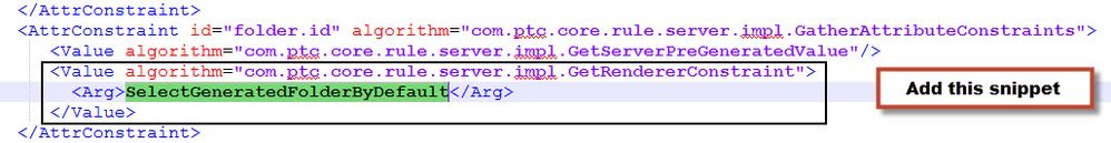

Hi @VillageFool12,
If you can modify OIR at the product level like below, and next time whenever you try ot create Part, it will automatically select the folder you wish to.

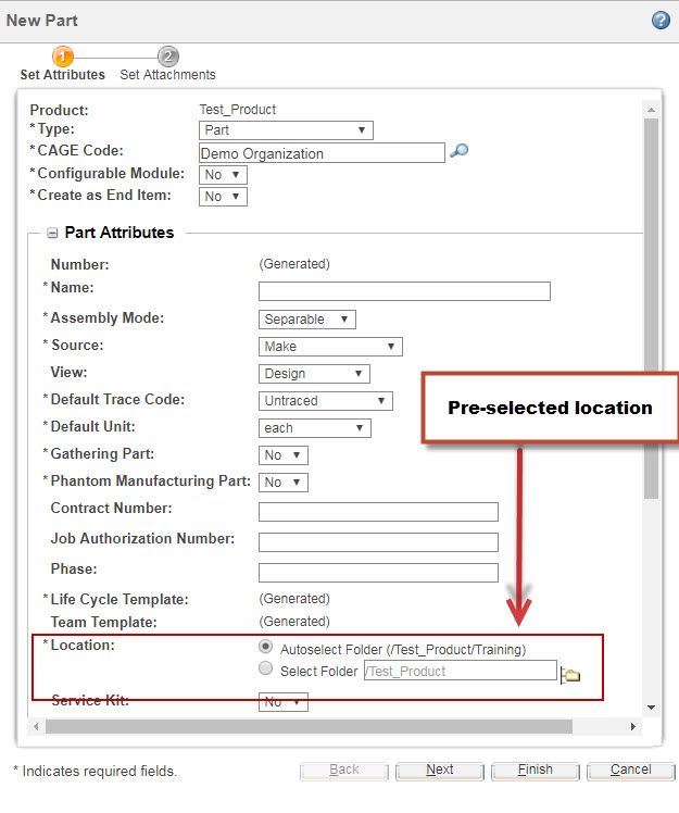

And while creating WTPart, wizard will be display with AutoSelected Folder path as below:
I hope this helps you.

Hi @VillageFool12,
Shirish
Thank you so much! Worked perfectly.

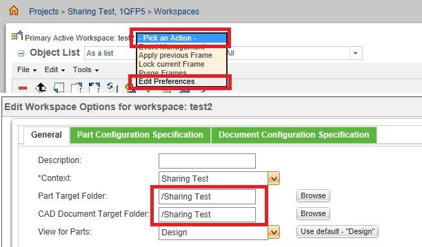

Another possible solution, if you want to leave a little control up to the people if your WTparts are generally created by auto association- There is a workspace setting for every workspace where you can dictate which folder new CAD and new WTparts are placedws_img.jpg
