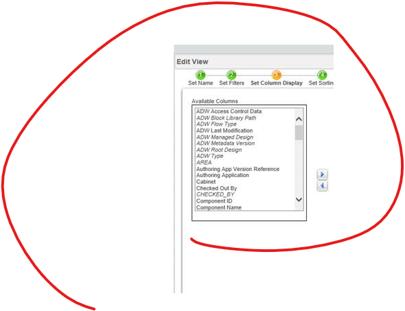

Hi all,
How can I add new column in avalible columns table? I can see that some of them was made previous.

Hi, thanks for reply.
I want to add few string columns to multi-level BOM report. My windchill version is 11.1 M010

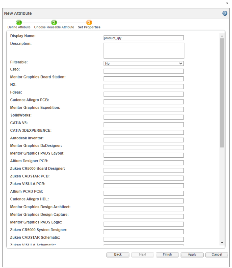

MattPat
(To:hlafkir)
I found out how to create an attribute. Another problem is how to assign value to this attribute.
I create an attribute "company_name" it should be always "Company XYZ". How or where I can assign this value?

MattPat
(To:MattPat)
if it will help attribute look like this
