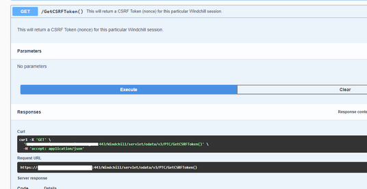

I am stuck and need suggestions what to do. I am trying to get CSRF_NONCE value, using rest query with java api (I working with Windchill 12.0 server). But what ever I do I get HTTP code 400.
Tried queries were: https://myServer/Windchill/servlet/odata/PTC/GetCSRFToken()
My code is:
URL url = new URL ("https://myServer/Windchill/servlet/odata/PTC/GetCSRFToken()");
HttpURLConnection conn = (HttpURLConnection) obj.openConnection();
conn.setRequestMethod("GET");
conn.setRequestProperty("Content-Type", "application/json");
conn.setRequestProperty("Authorization", "Basic " + authString); //authstring is Base64 encoded
conn.connect();

Hi @nbojcetic
You forgot to add a accept property string
conn.setRequestProperty("accept", "application/json");
I test it and it works

Hi @nbojcetic
Have you tried earlier versions? v1 ? v2?
go to the a restApi documentation and test it directly from the windchill if it works.
https://wch.server.com/Windchill/netmarkets/html/wrs/doc.html
PetrH
Yes i tried all from v1 to v4 . I looked into the logs and I found message that I do not understand:
2023-03-22 14:15:00,759 ERROR [ajp-nio-127.0.0.1-8010-exec-5] com.ptc.odata.windchill.servlet.WcRestServlet nenad - An unexpected REST error occured Not exactly one '/ at the beginning or at the end in format: *; q=.2
Its like that server has issue with the query string, but I did not see this before.
Nenad

HelesicPetr
(To:nbojcetic)
Missing set the accept properties as i mentioned earlier
PetrH

Hi @nbojcetic
PetrH
YES, that is correct and now it works. Thank you very much! 😊
