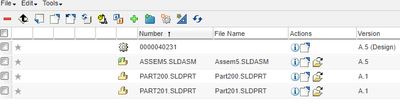

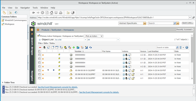

I have programmatically added objects to the workspace and checked them out. However, I am unable to check them back in using the same approach. Could you please suggest any available APIs for checking in objects in the workspace.
Please find the below image for your reference.
I have performed the checkout action using the below code.

If you try to check in what is your problem? you do not provide any errors . If you say it does not work, that means nothing.
Logs are the most important point for solving a troubles

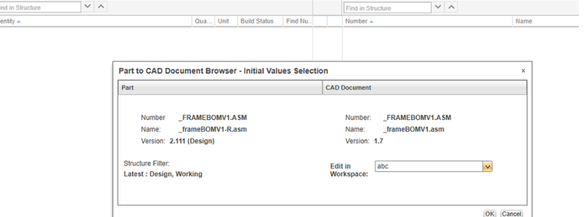

Windchill has a mechanism to build a structure from the WTPart to CADDocument
In a compare wizard, you can chose a Workspace where the CAD is modified from the WTPart Structure by Build One/Multi-Level CAD Structure
So Check-In from workspace API exists on the server side.

Hello PetrH,
Thank you
now its working fine no issues.
one more dought i have, i added one assembly in the workspace i do checkout and checkin, after checkin i want to remove the added things from the workpspace, how to achive this.
please refer below the image for your understanding. (after checkin i need to remove all the added things from the workspace)
Raikar
