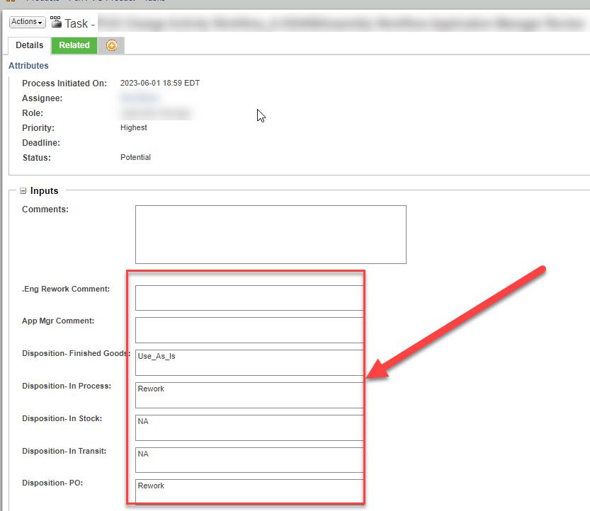

Can the boxes of parameters that are resettable for an Change Task Activity be enlarged?2023-07-20_10-21-44.jpg

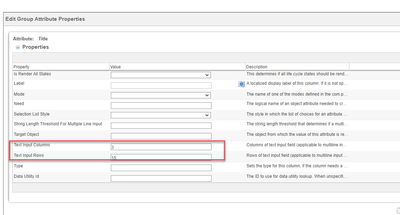

Try this: ( I used document type)

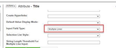

Input field type for the attribute has to be Multiple Lines

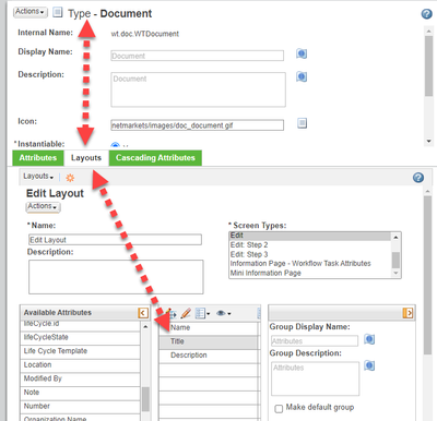

Go to actions > Edit on the type, then click layouts, the attribute, then the pencil above the attribute

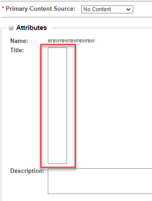

Edit number of columns and number of rows

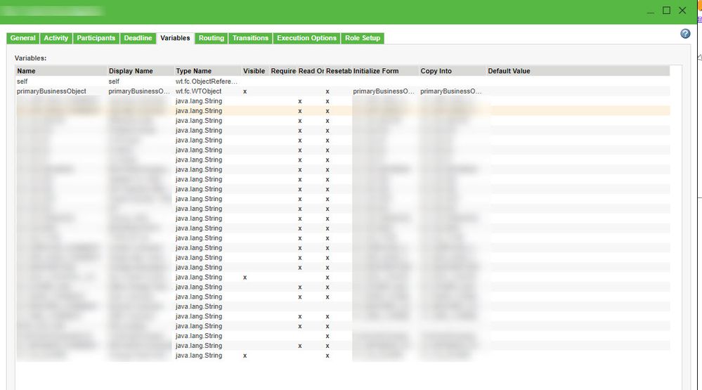

 @jbailey these are not part of the layout, but are part of the task that are defined here as visible.

I just used document since I already had some multi-line attributes there
Would have been nice.  The problem is that different tasks have different attributes, especially when you start to have workflows for different things other than CNs.
