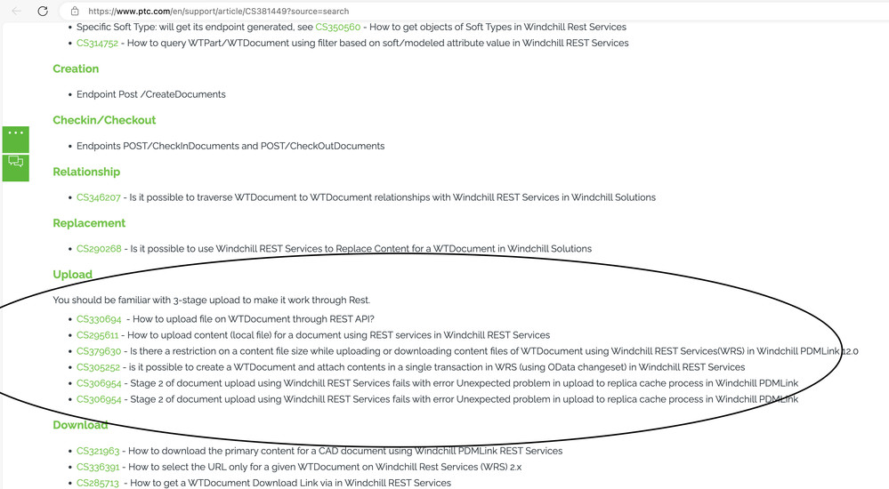

@SRINIVASAN1 Didn't understand, if you are able to upload it via postman, then you are using REST?!
This is related to both the Server and the Clients, you should adjust Apache HTTP Server config if you are using it as the Web Server.
Clients can fail: browsers, third-party apps, or postman, not all clients support large files.
The upload mechanism for WTDocument in REST is not transparent as the UI, Windchill usually uses the Vault mechanism to upload files, you should pass from 3 stages, which start from the cache vault until its last vault location. This mechanism in REST is somehow tricky!
See:
Article - CS381449 - [Knowledge Hub] Windchill PLM - WTDocument REST Services (ptc.com)
and  Article - CS369616 - [Knowledge Hub] Troubleshooting Failing WTDocuments Uploads in Windchill PDMLink (ptc.com)
