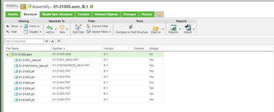

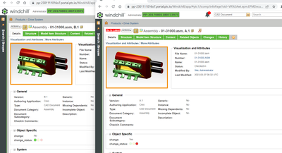

have posted  a workaround few seconds ago , it may take time to load video ., I'm not allowed to vote,  as i'm PTC internal
Fede
Fadel
23-Emerald I
(To:VP_8112620)
I tried to to combine , 2 calculated attributes , one string to get the status as string and a second long one to show the status as a graphical reoresenataion (xconfmanager -s com.ptc.GraphicalAttributes.enabled="true" -t codebase\wt.properties -p + sever restart to be enabled) ,
