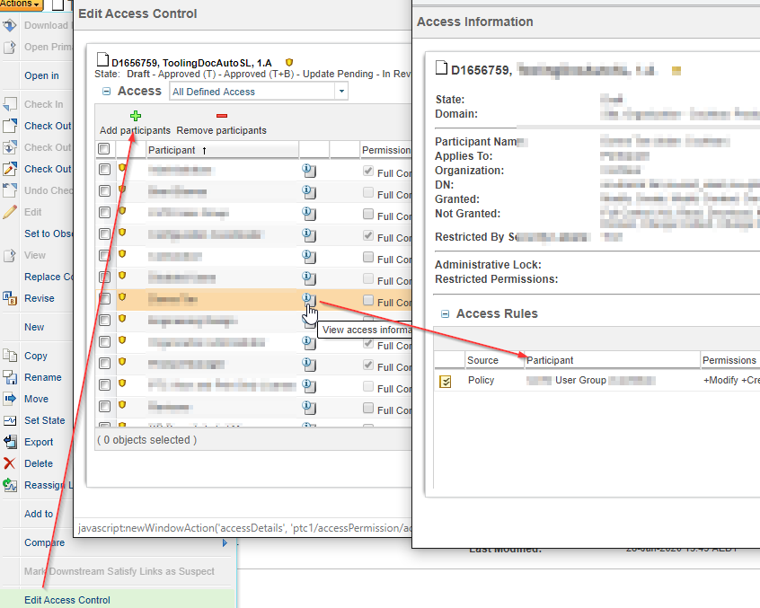

Use Access Information wizard to view where a user is getting permissions from.
There are quite a few reasons someone could be getting read.
1) You have 'read' granted to teamMembers (this is out of the box) and one of the roles in the context team has a group that is made up of all the users (or subgroups that effectively add up to all the users)
2) You have 'read' granted to the thisOrg pseudo role or some other group where the users are added and the permission is defined on group instead of to role
3) You have 'read' granted through lifecycle template (in Access Information the source will show up not as "Policy" permission but as "Life Cycle")
Also, it could be permission on WTObject (instead of WTPart for example). If you can't figure it out just give tech support a call, they will be able to recognise the source of the permission.
