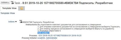

Hello, please tell me what type should be the variable obj ? I found an example of editing a template https://www.ptc.com/en/support/article?n=CS150777 , but there was a problem with the type of variable, tried everything I knew and everything that was recommended, it did not work to pass the test.

Ok sorry, just saw your reply there. I think there is something wrong with your code. Is this what you wrote after the suggestion from @zsternal-2
wt.fc.Persistable persistable = (wt.fc.Persistable) resulting.nextElement();
If yes, and it did not work, please post the full code.
yadavankur, this is the whole code, nothing else was added

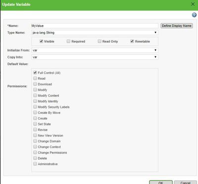

Has the local variable been initialized from and copied into the global variable? These were options when you were creating the local variable.
yadavankur, yes, initialized the variable, maybe the code itself I misunderstood what it does and how to fix it to get the table and display it
