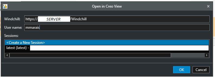

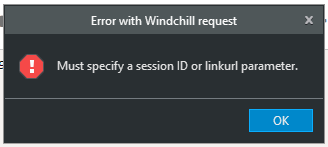

Session IDs appear to be a 1 time use thing, they expire immediately after use and I get this error if I try to use the link a 2nd time:
How can I get the linkurl parameter? Currently from the Base64 Decoding it seems I'm passing a session ID argument...
I also would like to automate opening and merging a bunch of links at once, are there any parameters to bypass this window? Such as to merge a bunch of creoViews into a single session or to open them all separately.

Article - "Using the app View and Measure in 3D fails with "Must specify a session ID or linkurl parameter"": https://www.ptc.com/en/support/article/CS275729
Not helpful, the reason I get the "Must specify a session ID or linkurl parameter" error is because the session ID expires after use.
As soon as someone uses the generated link it expires. I want to make the link permanent IE I someone can click on the link more than once.
I want information on what a linkurl looks like.
