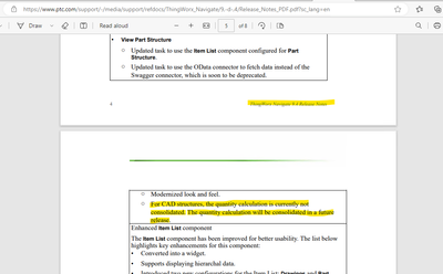

As mentioned in this document thingworx navigate 9.4, can we expect consolidated quantity from next version of navigate or next version of windchill ?

If PTC writes "in the future" be sure it takes several years 😄
nice example is filename length in Creo :D.
PetrH
Okay Thanks
