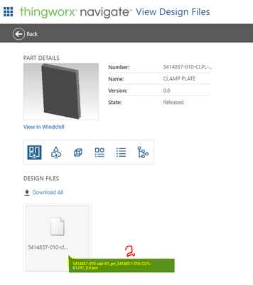

Is there any custom API or way to publish the required cad files to get the additional representation from thingworx.
If any please help me to achieve this.
Thanks in advance.

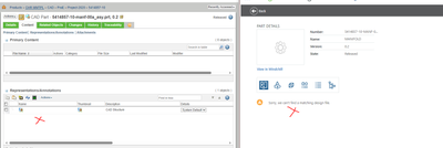

Hi @PEHOWE
For Example, take a cad part/asm/drw which contain any additional files (1), will appear in the view design files (2)
in my case the file is released and doesn't contain the additional files, I need an option to publish the file to get additional files for the specific cad part/asm/drw.
Snaps are shown for understanding purpose with OOTB apps, but we have a custom application built with similar kind of function. we need to implement the trigger/start creating representation for files that don't have the additional files from thingworx.
Keerthi

Hi @PEHOWE
Getting all file content (representations) from windchill using REST API is currently available but what I need here is that I need to trigger the publishing (create new representation) option from Thingworx side.
Thanks.
