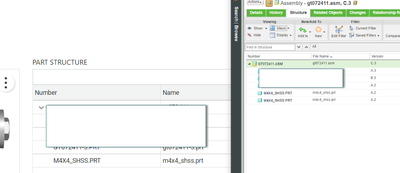

Have anybody using out of the box View Part structure app? The tree widget in Thingworx removes the duplicate part numbers. That really becomes data integrity issue. We only see one occurrence of the M4X4_SHSS.PRT in Thingworx Navigate .
How have you handle this?

Hi Preeti,
You are right. It looks like a BOM. If you add the quantity you see that it is twice:

Thanks. I did not realize that. Dah.

Hi Henning,
Could you please help me in telling steps to how to add this quantity in Part Structure App of Thingworx Navigate.

You can add the quantity in Part Structure Appas follow:
