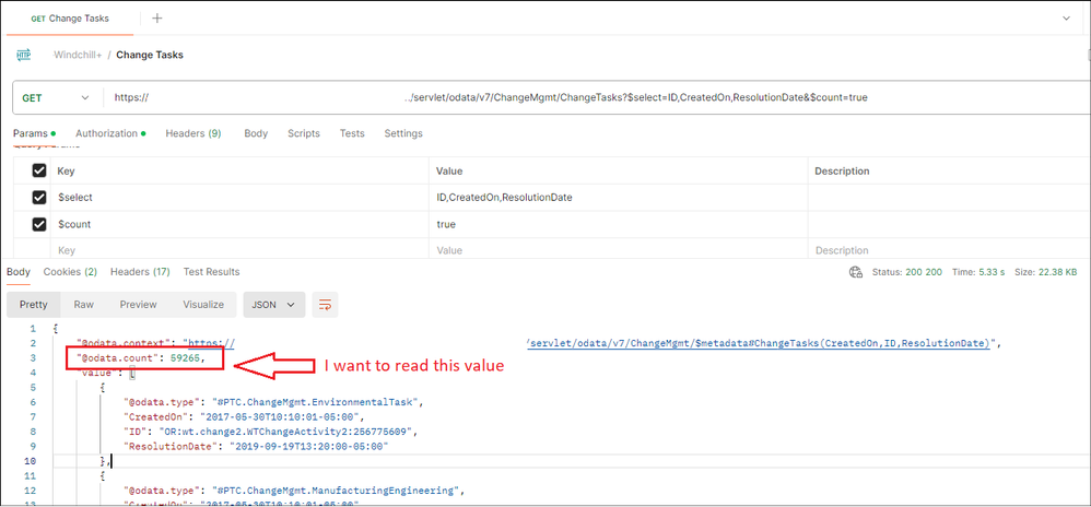

I am trying to read the count of object returned by WRS in ThingWorx/Navigate service. The count information is captured by "@odata.count" key in the WRS response.
Windchill Response:

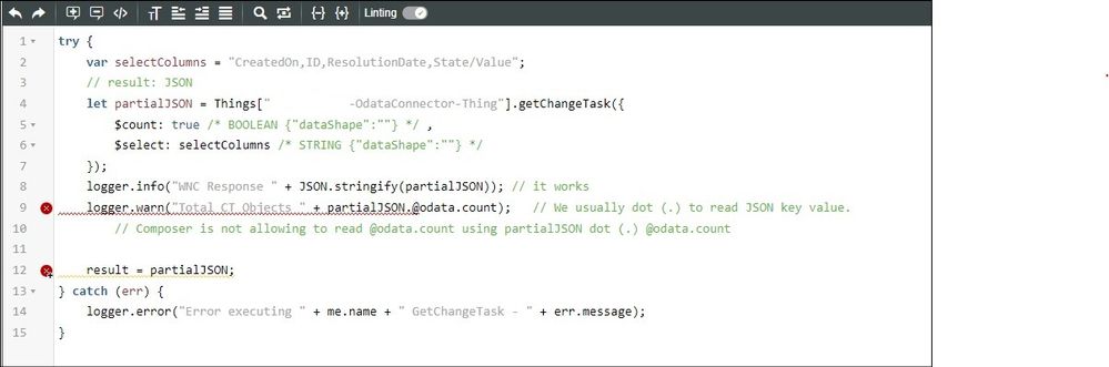

From ThingWorx service, if I use dot (.) to read json key values. In case of @odata.count, ThingWorx composer is throwing syntax error.

Any idea how to read JSON key values having @ in the key name?

Nevermind, I am able to make it work by adding double quotes ( " ).
