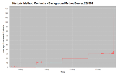

I've been tracking a vexing issue for a few weeks now. I would get a note from the users that they are not seeing emails, publishing has stopped or workflows are not working. Quick check on System monitor shows red lights on BGMS:
Threshold of average active method contexts exceeded; average active contexts: 135.0001
 It appears as if no queue jobs are transacting. This will persist until I whack the BGMS process and it auto-restarts. Queue jobs start processing normally and there is an email flood. What is strange is this often occurs at night or weekends. I am checking with IT to make sure this is not an external job that is running. I would think if it was DB related, it would settle back down once issue is resolved. I am still investigating issues on that front. Here is the status messages before the event:

I would check what is the average active method contexts and increase the value and check if it can help.
Why this threshold is exceeded in the night? it is interesting, do you have any custom drill action to export data to another system?
This can be a case.
PetrH

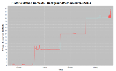

If there is a limiter, I can get how two many contexts getting spawned and they all get stuck in the exit door. I am not sure how widening the door would help if we do not know what is spawning them. This is all happening in the morning on a Saturday when the system is idle. No one is online doing things then. I am checking for external causes like something on the database but nothing obvious yet. There are some queue jobs like the Purge Report task that runs daily at 10:30am. We do have a few data monitors but the frequencies for clean up do not align. I have discounted this. This is the key data I think:
ActiveContextsAverage=130.0123936803109, ActiveContextsMax=132, ActiveContextsStart=128, ActiveContextsEnd=132
It spikes at this time and stays this way until restart. I think I will setup a monitoring period that morning and try to trap any DB calls and other activity to see what is the trigger.

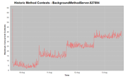

I am on CPS 8 so no luck for me. Since the failure occurs at about same time of the day, just not any particular day, here are my current working theories:
  • A certain scheduled job runs and locks the tables but fails to release.
  • A different job locks the table and fails to release but issue is only problematic when another scheduled job which runs at that special time comes along and runs into the lock.
I believe the cause to be a traffic jam of active contexts spiraling up to the maximum. Essentially, they all get stuck in the doorway.
More info. This appears on a regular cadence (just restarted) but I am still baffled. I am linking in CS244172. I will note that max DB connections is 15 and I've always had that value set. There is also this curious pattern of Method Server context that does not make any sense.
and then when it went haywire:
I do see a message at 10:32 am that there was a successful QueueLock for the commonProcessorQueue but that its. It never releases it but nothing ever reported that it also asked for it.
