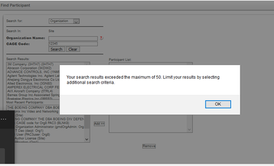

Cannot search for OrgPrincipals using CAGE code as criteria on Participant Administrator
When searching for Org Principals using CAGE code as criteria, search errors because it is returning to many results.
It does not matter what CAGE code value you put in, it always returns too many.
Here are the errors that I faced
Too many results returned
It looks to me like the QueryPrincipalsServerHelper.class is expecting to see organizationIdentifier in the paramString but what is there is actually ptcUniqueOrganizationIdentifier, so the sql query has incorrect where clause.

Here is some output from method server log.. it is not from the same query as above but you can see that the 'ptcUniqueOrganizationIdentifier' value that is input in the GUI does not make it into the sql query where clause.
2022-02-17 13:10:05,985 DEBUG [ajp-nio-127.0.0.1-8010-exec-3] wt.org.QueryPrincipalsServerHelper wcadmin - In getDatabasePrincipal : principalClass class wt.org.WTOrganization, criteria(((name='*steve*'))&((ptcUniqueOrganizationIdentifier='*123*'))), containers.size() : null
2022-02-17 13:10:06,001 DEBUG [ajp-nio-127.0.0.1-8010-exec-3] wt.org.QueryPrincipalsServerHelper wcadmin - filter value: (&(name=*steve*)(ptcUniqueOrganizationIdentifier=*123*))
2022-02-17 13:10:06,001 DEBUG [ajp-nio-127.0.0.1-8010-exec-3] wt.org.QueryPrincipalsServerHelper wcadmin - getDatabasePrincipal qs: SELECT A0.*
FROM wt.org.WTOrganization A0
WHERE (UPPER(A0.name) LIKE '%STEVE%') AND (A0.internal = 1) AND (A0.status = 'public') AND (A0.disabled = 0)
joins=null

Thank You for your reply!
I should have explained the issue better.. The problem is not that it won't let me see the results. The issue is that adding more detailed criteria does not reduce the size of the result set. There is something causing the cage code criteria to not be included in the database query.

I also see in 12.0.2.2 that when searching for an Organization, the Organization ID criteria (CAGE code) is ignored. Whereas it is taken into account when searching for users.
Unfortunately above SPR is not fixed, neither 12.0 nor 12.1.

I have opened ptc case: C16266449
