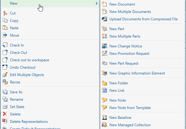

I have a brand new install of PDMLink 13 and noticed in my testing that both Change Request and Problem Report are missing from actions. I am still in the middle of configuring things so I have applied my customizations from 12 and brought in my lifecycles, workflows and OIRs. I do see Change Notice and Promotion Request. Scratching head here but I am sure its something simple.
I do have some additional actions like Delete Representations that I added in. I checked the licenses and the user I am testing does have Windchill Advanced license among others. What's weird is that if I look at jcaDebug, its not even greyed out.

Could you please verify if the actionmodel namded folderbrowser_toolbar_new_submenu is in Windchill/codebase/config/actions/custom-actionModels.xml?
If there is, please compare the actionModel definition with OOTB one which is defined in Windchill/codebase/config/actions/FolderManagement-actionModels.xml.
The following two actions should be in the model with name folderbrowser_toolbar_new_submenu, like below:
<model name="folderbrowser_toolbar_new_submenu" resourceBundle="com.ptc.windchill.enterprise.folder.FolderActionResource">
<action name="create" type="changeRequest" shortcut="true"/>
<!-- New Change Request -->
<action name="create" type="problemReport"/>
<!-- New Problem Report -->
</model>

Perhaps I spoke too soon. There seems to be a more fundamental issue. I have reset custom-actions.xml and custom-actionModels.xml back to original (empty) and verified that all the OOTB actions and actionModels in the config/actions folder is OOTB (dated 6/25/2024) to 13.0.2 CPS 4. I cleared tomcat cache, cleared compiledTasks and ran MakeJar. I hope that is all I need to do to clear things. Upon restart, things look ok but UI quickly starts throwing weird messages like below that I do not understand. So my initial title of post might be off. Here is what I am seeing in logs:
(com.ptc.netmarkets.util.misc.miscResource/400) com.ptc.netmarkets.model.NmException: actionmodels.xml file is missing an entry called product navigation.  Please add the model and restart the server.
ctionmodels.xml file is missing an entry called clfAdmin navigation.  Please add the model and restart the server.
com.ptc.netmarkets.model.NmException: actionmodels.xml file is missing an entry called action search table toolbar.  Please add

The errors above are in no particular order, just snippet from Methodserver logs to jog any of you out there. When I started this, things seems ok for a new install. I started my configuration creating soft-types, creating attributes and applying customizations. Things were ok when imported workflows, lifecycles, OIRs, creating groups and contexts. As I mentioned, I saw some of my custom actions but then I noticed some OOTB things missing. As far as I know, what I seeing is not database related it is? when changes are made to actions and action models, do I have the proper steps to clear and rebuild setup?  My next steps would be to try and unwind some of the customizations I've added. I can't imagine much dependencies on custom classes or other additions.
